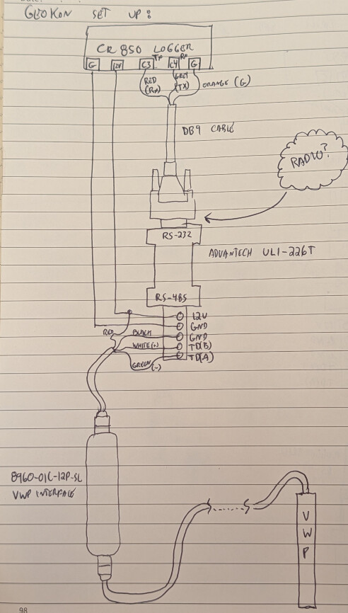

I’m in the bit of an I/O pinch and need to get a serial pressure sensor, either an in-situ rugged troll 200 or GeoKon 8960 interface, to talk to a Campbell Scientific Data Logger Com port (only Tx and Rx). Unsurprisingly both of these sensors are RS-485.
The Campbell Scientific Logger has 0-5V RS-232 on the com port: e.g. Com2 has Ground TX and RX. I can also switch to TTL which I think just inverts the logic.
COMMUNICATION 9.1 – 8 10 30 RS-232 PORTS: DCE nine-pin: (not electrically isolated) for computer connection or connection of modems not manufactured by Campbell Scientific. COM1 to COM2: two independent Tx/Rx pairs on control ports (non-isolated); 0 to 5 Vdc UART Baud Rate: selectable from 300 bps to 115.2 kbps. Default Format: eight data bits; one stop bits; no parity. Optional Formats: seven data bits; two stop bits; odd, even parity.
From what I can tell this should work.
Unfortunately when I plug this into a rs-232→rs-485 converter the return logic level is 0-10V. I didn’t realize the return logic was out of spec (both for the CS logger and the Lora Serial Kit). I did test it this way (sans LoRa) which did work. but not something I plan on repeating.
I’m not sure if the LoRa Serial kit can handle 0-5V RS232 or if it’s worth my time trying to find level shifter or isolated converter or something that will keep both sides of the LoRa happy.
