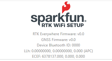

Torch WIFI page resets between access and battery indicator appears?
I recently picked up a pair of Tri-Band Torches, both had RTK Everywhere Firmware v1.2. I tried to upgrade to d2.3 without any success. I back tracked to eventually settle on v2.2, but I ran into issues. I have been trying to use the wifi config but there is a weird refresh of the page when the battery icon gets displayed, before the battery the data at the top of the page seems to be correct, ie Firmware versions, Device Bluetooth ID, and location data, when the battery icon appears the data at the top refreshes and it changes to a lot of zeros? And if I do a save of the profile errant data is written to the profile.
The latest problem I encountered was when I tried to configure the unit with the terminal program I saw the info being displayed was rushing by and stating BT connected, BT disconnected on the very next line, I could hit a key and bring up the menu but the next line would flash by so quickly I could not access the menu, the bluetooth light was solid blue and I didn’t have anything connected. I tried to connect with uPrecise but got an error device not supported, and if I hit the +++ it went into “Command Mode” which I couldn’t figure out how to reset? The only way I could regain control was in terminal, I held down the s key while very quickly tapping the return key, it would work only sometimes, the s would stop the menu and the return would bring up the system menu, when I go there I was able to disable bluetooth to stop the data stream. If anyone else knows of a better way please let me know. I am at v 2.0 for one of the unit with the Unicore firmware at 11833 and the second unit at v2.1 and the same 11833.
I need a stable installation to use the LoRa radios which I have already updated to v2.0.2
Thanks for any help you might be able to provide.

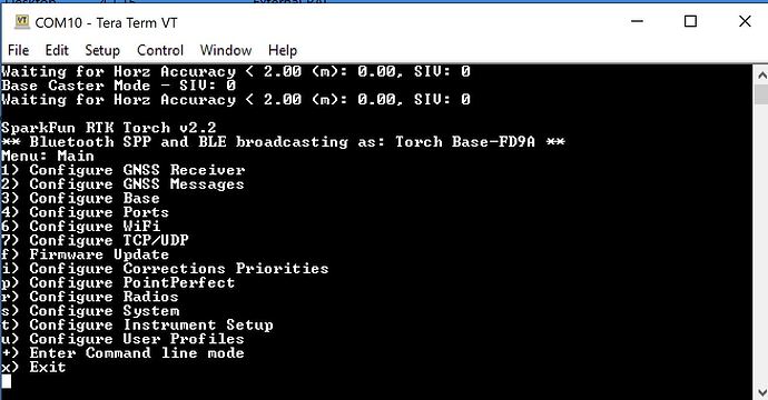

And another snippet of the second unit terminal session
SparkFun RTK Torch v2.2
** Bluetooth SPP and BLE broadcasting as: Torch Base-FD9A **
Menu: Main
  1. Configure GNSS Receiver
  2. Configure GNSS Messages
  3. Configure Base
  4. Configure Ports
  5. Configure WiFi
  6. Configure TCP/UDP
    f) Firmware Update
    i) Configure Corrections Priorities
    p) Configure PointPerfect
    r) Configure Radios
    s) Configure System
    t) Configure Instrument Setup
    u) Configure User Profiles
    +) Enter Command line mode
    x) Exit
    STATE_BASE_FIXED_TRANSMITTING → STATE_WEB_CONFIG_NOT_STARTED

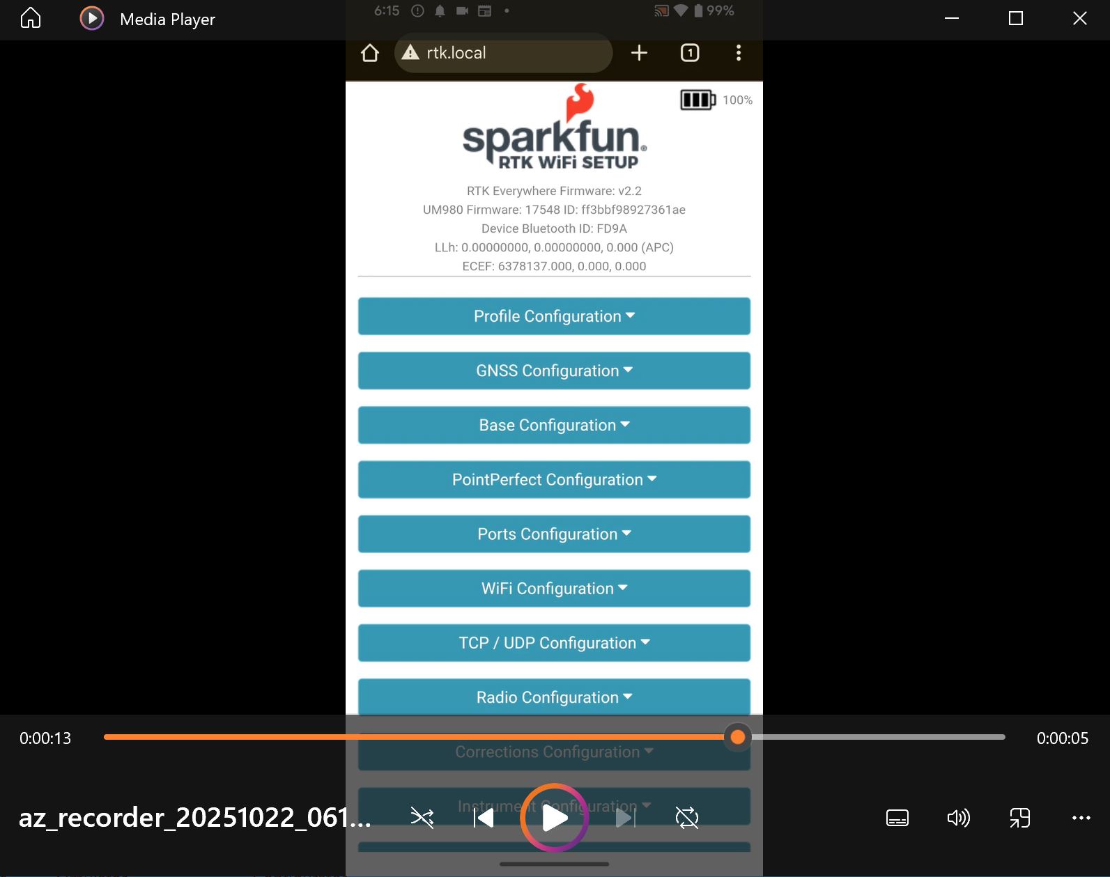

Here are screencaps of the data before the battery icon and after the icon appears, somehow there is cached data the can be mixed with the actual data that isn’t seen.

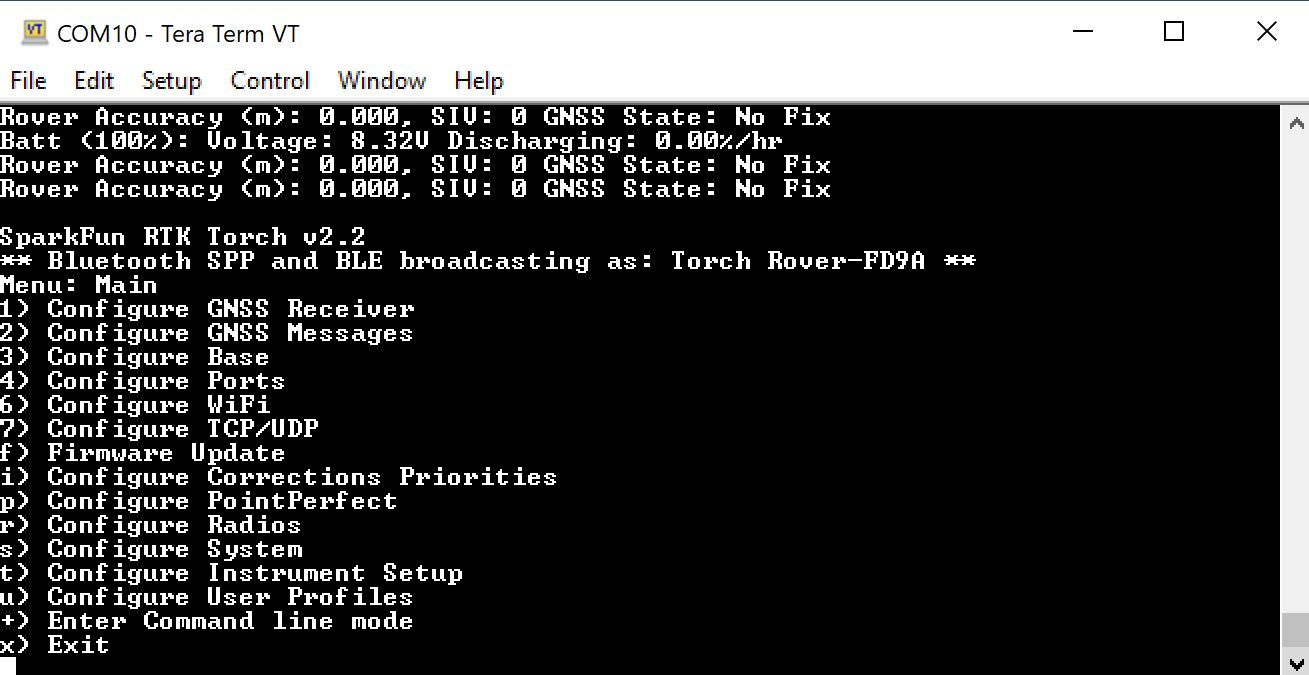

except my Torch does something similar at times.
After a [Reset all settings to default] via serial:
I’ve never bothered to gather any hard evidence, but my assumption has always been this happens when I mix/match Serial and WiFi Config modes and somehow get the FW tripped up.
I tested the base unit to add a second profile and it didn’t work.
Below is the Torch running Profile 1, you can see that the upper right corner states Torch Base-FD9A.
But when I switch to Profile 2 the “Base” comment disappears, additionally the Bluetooth light does not blink and the casters do not function.
This unit will show a Wireless ConFig connection but the webpage does the above refresh.

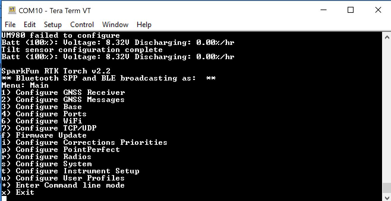

I seem to have real problems going to Profile 3?
I captured some of the terminal output switching Profiles back and forth.
Switching from Profile 1 to Profile 2

I have an issue with one of the Torch’s wireless connection as it shows 2 profiles, the second not actually used with the name 0123456789. I will formalize the install procedure. The units are working as I can get a RTK Fix without a correction source other than the LoRa radio connection.
I’ve uploaded the firmware several different ways and have the same result as a second profile corrupts the install.
Image one is profile 1 it shows the name the profile has given the unit Torch Rover-FD9A**
Whereas image two which is profile 8 shows no name being broadcasting, the blue light is on and doesn’t flash and there is no connection via bluetooth to the phone.
In both cases nothing has been edited except for the name of the profiles.
Thanks Mike,
Is this the same issue as:
I.e. did you create the ‘corrupt’ profile through web config?
If so, the any of the Release Candidate firmware from Sept 4th onwards should cure this issue. But please make sure you perform a Factory Reset (go to the Factory Defaults) to clear the corrupt profiles. If you copy your profiles across via SD card, they’re likely to still be corrupt.
No, I don’t believe so, I think I was using the serial config to create the profiles. When I see in the web config mode that the profile doesn’t have the name I gave it and the second profile is just digits than I know not to make changes using the web config, cause that will corrupt the profile for sure. I am using my second Torch as a rover, no configuration except the LoRa radio is turned on, I can make changes using web config on that unit as the webpage shows the correct data but it doesn’t take effect until the unit is power cycled?
Thanks Mike,
I’m really puzzled by this.
Random thought: do you have any special characters in your WiFi or NTRIP passwords? A comma would cause all kinds of chaos - especially for the web config. We transfer the settings to the config JavaScript in Comma-Separated-Value format. Any extra commas will do very bad things. The same may be true for underscores, but I need to think that through a bit more.
Hello Paul,
Thanks for taking the time to help, no special characters in the ntrip but the WiFi has a space and an underscore in the hotspot name “Moxee Tether99_2.4G” and my home/office has an underscore “MGPHOTO_WIRLESS” I have a pair of Facets that don’t seem to have any problem with my WiFi setup.
