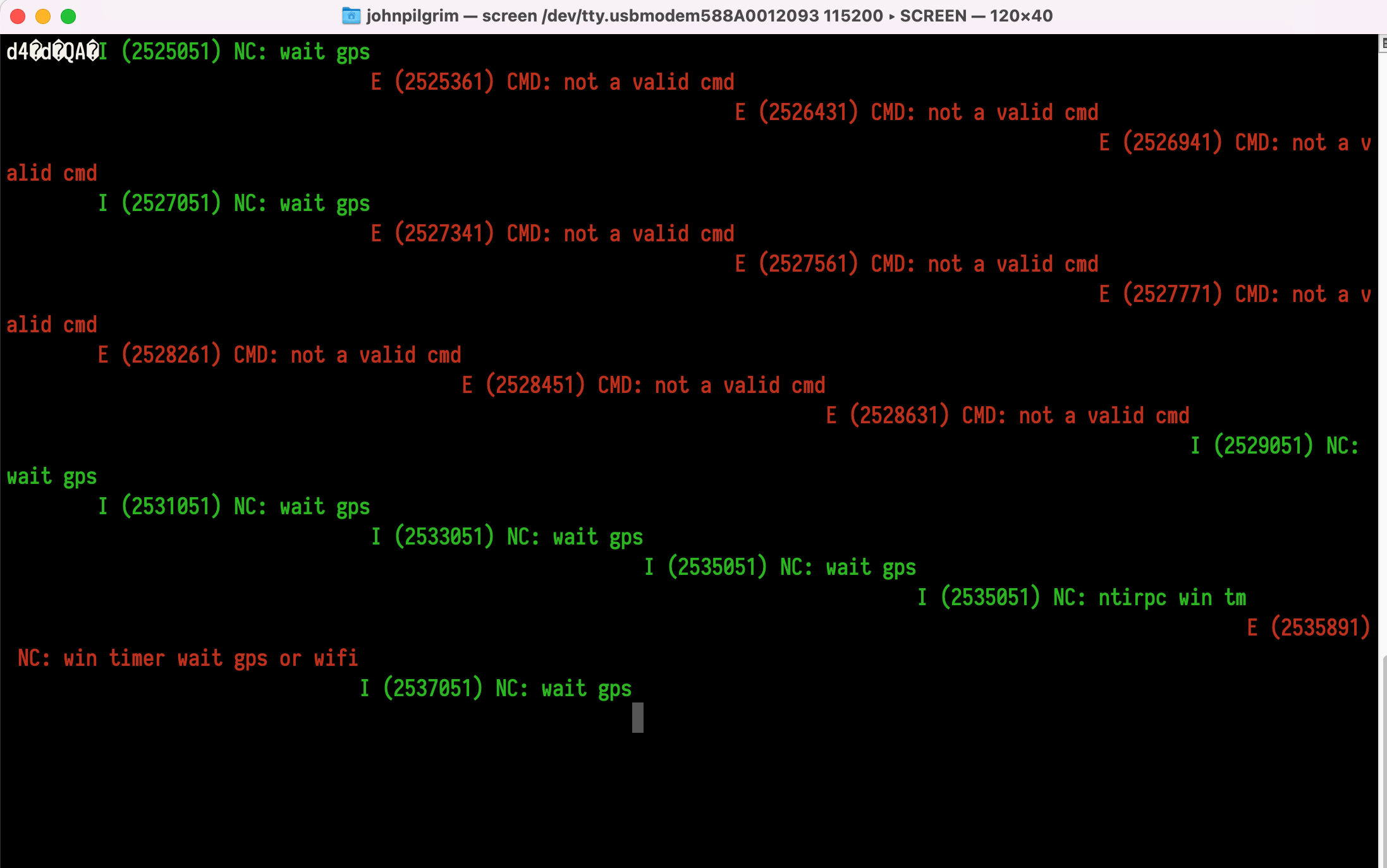

Hi all,
When connected via USB Serial, I get an error “CMD: not a valid cmd” when I press any key per the instructions “Press any key to open the configuration menu.”
CoolTerm:
MacOS Terminal screen:
I am guessing that my serial terminal is misconfigured and my outgoing character bytes are incorrectly formatted.
Are there some additional serial configuration parameters that folks know to work?

Thanks for the reply Russell
The issue reproduces in YAT and PuTTY on Win10 (see screenshots below), so it’s not a macOS issue.
I’m using the correct COM port.
I could use BT or other connection methods, but I’d like to understand why the behavior of the RTK Torch does not match the documentation at Configure with Serial - SparkFun RTK Everywhere Product Manual which says it applies to the RTK Torch
Thoughts?

Assuming at least one of my four serial connections is accurately sending what I type to the Torch across the USB Serial, my question becomes:
Since “press any key” is not what the Torch is expecting, what is the command to bring up the config menu on USB Serial on the current Torch firmware?

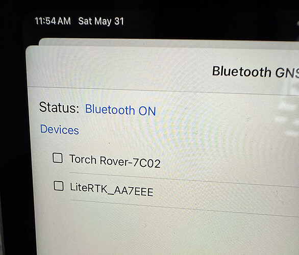

OK Sparkfun, you seem to be shipping Torches with two different firmwares.
I have two Torches, purchased many months apart.
The newer second torch is the one that is giving me the “CMD: not a valid cmd” error in USB Serial.
So I decided to try the first older Torch, and guess what, it works as described in the documentation:
A further observation that leads me to think “two firmwares” is that the older torch enumerates as " Torch Rover-####" in SW Maps, while the newer torch enumerates as “LiteRTK_######”.
A third observation is that the newer Torch didn’t have the printed stickers with the serial numbers and PointPerfect IP trial code in the box.
So how do we get the issues with the newer Torch resolved?
