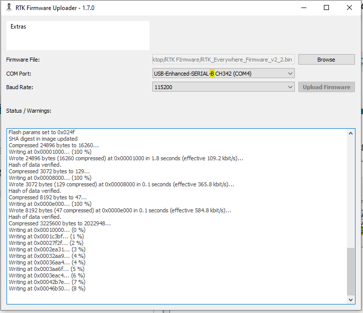

On the Torch, make sure to select Serial B for updating the FW.
I’m not using Windows, so those are not my options:
(attachments)
