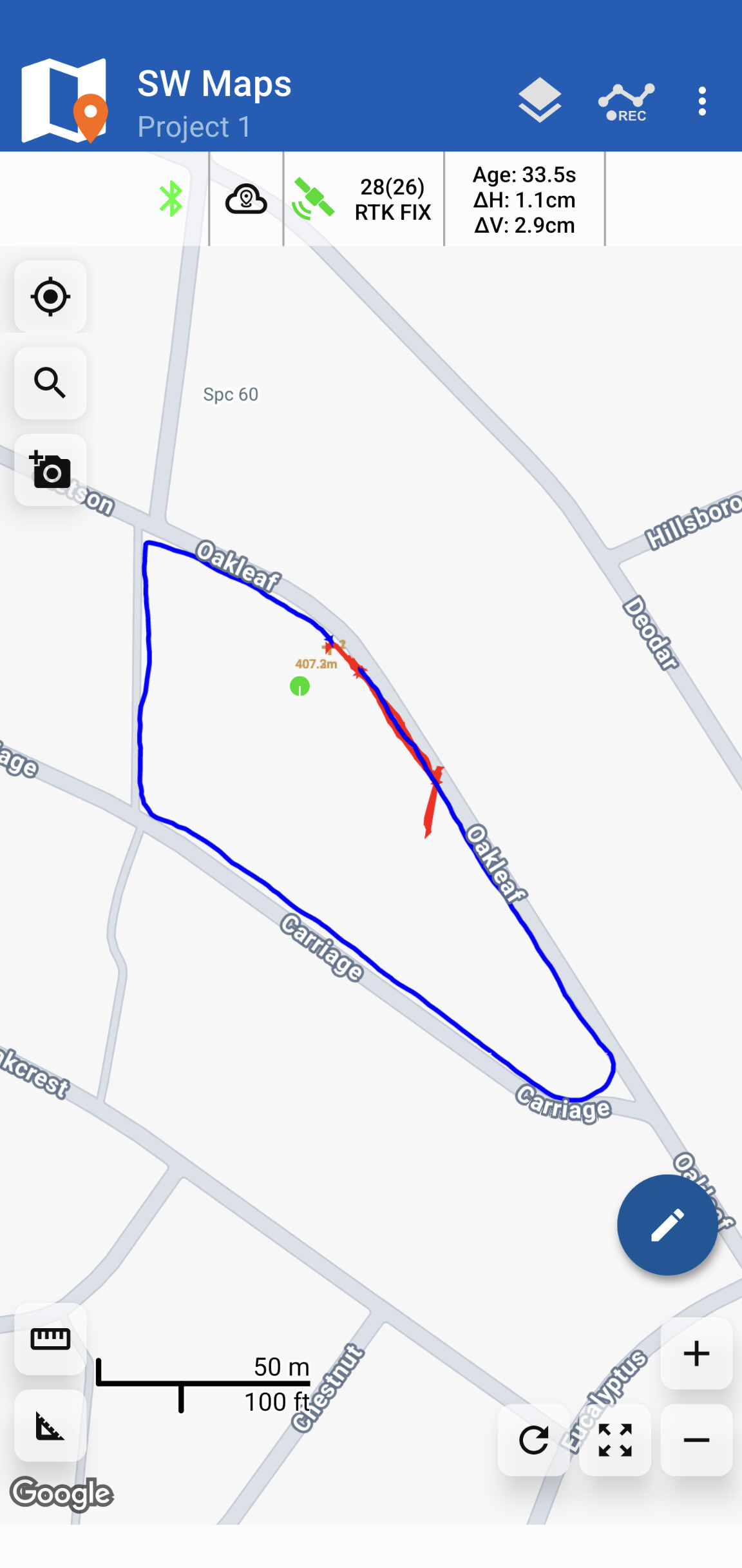

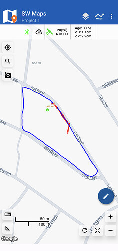

This image below is a test I did the other evening both Rover and Base on v2.2.
Red line is a track using my wifi connection which gets out about 75 feet, the blue line is the Base and Rover using LoRa only for corrections.

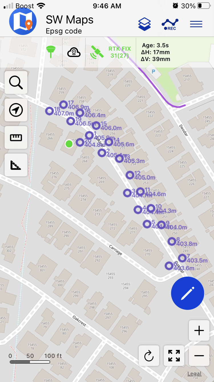

The next image is from this morning using the Base v2.2 and the Rover d2.3. I had to use Serial Terminal to jump start the unit into Base with Caster. Point #20 is after I had restarted both Base and Rover, in addition to having to restart the iPhone multiple times.
