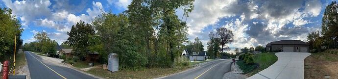

Testing Oct 9th 5pm. Better… but in mostly wide open in my opinion it lost RTK Fix after only about 100 points averaged. Then in about 5 min got it back for 60avg, lost it briefly then averaged continued to get to 120 before writing it.
And I did it 3 times and via SW Maps it said the 3 readings were 0.9ft apart?(Per SWMaps, however when I exported and had ChatGPT calculate distances apart point 1 was 5 inches from 2&3 and 2&3 were only 0.75 inches apart) even when the points were recorded with RTK FIX avg of 80-12 readings each?
Does this look like too much surrounding trees to maintain RTK Fix??
, or do I still have some software configuration issues? No PPL error on push to UM980. And it seemed to be downloading bytes from PointPerfect and pushing them over to UM980 without error.
clarifying the first reading where RTK Fix failed after 60 average points was 5 inches away from points 2 and 3. Points 2 and 3 recorded as only 0.75 inches apart… darn good, but not good that within 15 minutes they should all be 0.75 right? I’m I just expecting too much from PointPerfect corrections and bad cell service? And trees and not a wide open 100 acres field in Iowa?

Quick update - results are very promising but one day of testing can be …. Misleading. I was able to maintain RTK Fix for over an hour and also went down into the valley behind my house 40-50ft down from test track and surrounded by woods and maintained RTK Fix for 10 minutes…. Then it started raining. Tomorrow I will test more extensively
You’re going to love the RTCM PP over NTRIP :wink:
It can’t perform any special magic under heavy canopy, but I’ve found it far superior to the “old” MQTT PP. I think that’s mostly due to being OSR verses SSR.
Day two - test 1 - My configuration is FACTORY defaults, RTK Torch software version 2.2
The only settings changes I made were to Add the Credentials @sparky gave me, add WiFi configurations, and set PointPerfect Corrections to FLEX NTRIP/RTCM
I am getting RTK Fix in under a minute (restarting at nearby shutdown point so may resolve faster)
But it’s resolving and keeping RTK Fix. And it’s raining and cloudy so that might reflect signals, but it’s working like a champ…. I want to drive to the Farm/Forest right now!!! Awesome so far.
I didn’t even change the MINIMUM ELEVATION FOR A GNSS SATELLITE
or MINIMUM SATELLITE SIGNNAL LEVEL FOR NAVIGATION
although once in my dense woods, I may need to experiment
Once it stops raining I will put on boot and just hike into the woods behind the house to test, which has as bad a view of the horizon as most of my woods, good test without driving 45minutes to the farm….. I AM VERY EXCITED!!!
