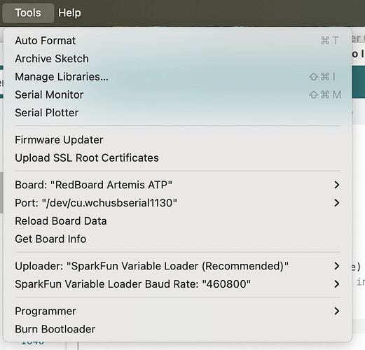

Ah - are you using an esp32 S3? You might need to enable CDC on boot
No, I am using the Open Log Artemis, which I believe is an ā€œAmbiq Apollo 3ā€ processor.
I looked in the tools menu, there is no ā€œenable CDC on bootā€ option present for this board.
